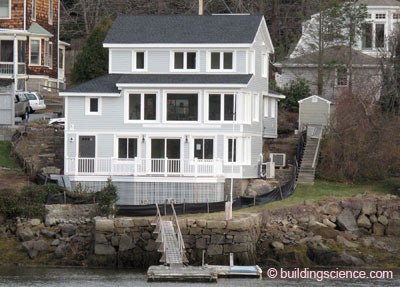

In 1920, when this house was built on the bank of a coastal cove, it served as a summer cottage complete with a boat dock. Over the years, the house has been remodeled, added to, and converted to a year-round residence. Now, as part of the latest renovation, it has undergone a deep energy retrofit which is projected to achieve a 43% source energy savings for the occupants. The National Grid Deep Energy Retrofit (DER) Pilot Program provided technical and financial assistance for the energy saving improvements of the renovation.
While the exterior of the house still looks much like it has looked for years, the DER portion of the project has significantly improved the performance and durability of the enclosure on all sides of the house. The above grade portion of the house was wrapped in insulation on the outside and the below grade portion was wrapped in insulation on the inside. In addition, air tightness and water management was improved, mechanicals were replaced with energy efficient systems and a solar hot water system was installed.
The result is an energy efficient, air tight house that is comfortable year round and that should be able to withstand many more years of nor’easters along the Massachusetts coast.

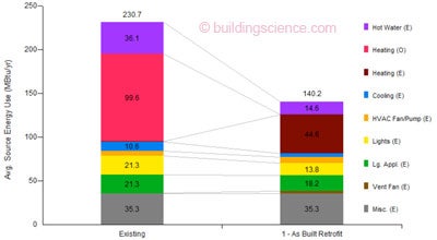

Estimated Annual Energy Savings: Projected 43% source energy use reduction compared to pre-retrofit conditions
Image from BSC generated by NREL’s BEOpt 1.1 for retrofits

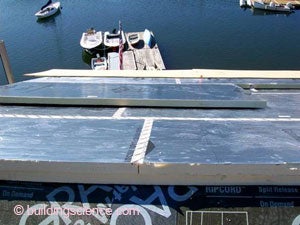

Roof Assembly: R-67 (nominal) unvented roof assembly: new asphalt shingles over underlayment and new plywood; three 2” layers of foil-faced polyisocyanurate insulating sheathing with seams offset and taped; continuous layer of fully adhered membrane over existing roof sheathing; 8” of netted cellulose in rafter cavities.
Foil-faced polyisocyanurate insulating roof sheathing (p
hoto courtesy of Tobias Richon)

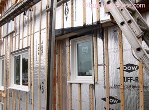

Wall Assembly: R-38 (nominal): Fiber cement cladding installed over 1x4 vertical furring strips; two 2” layers of foil-faced polyisocyanurate insulating sheathing with seams offset and taped; taped housewrap applied over existing board sheathing; existing wall cavities filled with cellulose.
Vertical furring strips over polyisocyanurate

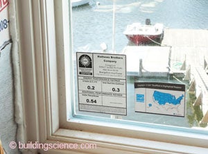

Window Specifications: Mathews Brothers triple-glazed, argon, low-E vinyl, flanged, new construction casement and awning windows, U=0.2, SHGC=0.3; windows installed in alignment with the existing board sheathing.
New consruction triple-glazed windows

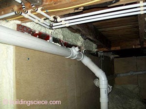

Infiltration: Air barrier system is as follows: existing basement slab with two coats of epoxy paint; taped rigid insulation on inside of foundation walls; spray foam at the rim joist; taped housewrap on above grade walls; fully adhered membrane on existing roof sheathing; transitions between roof and above grade walls made by lapping membrane over the housewrap; other transitions made using sealant.
Spray foam at rim joist
(photo courtesy of Tobias Richon)

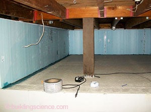

Foundation Assembly: Conditioned basement with 2.5” of taped XPS insulation and 1” of rigid polyisocyanurate applied to inside of concrete block foundation walls and covered with plywood. Existing basement slab covered with two coats of epoxy paint (for air sealing and vapor control) and then with 2” of XPS rigid insulation except at the workshop area which has no insulation and the living area which has only 1” of XPS.
Taped XPS insulation

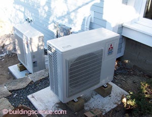

Heating and Cooling: Two mini-split multi-head air source heat pump systems with backup electric resistance on each floor and in baths.
Air source heat pump

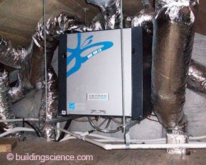

Ventilation: Fully-ducted HRV located in attic with exhaust taken from the baths and the kitchen and supply provided to the basement living area as well as to the first and second floors.
Heat recovery ventilator

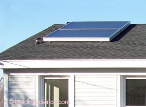

DHW: Solar hot water system with 28 ft2 of flat plate collector and 92.5 gallon storage tank with an electric immersion heater for backup.
Solar hot water panels

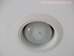

Recessed light
All existing windows, which were primarily double hung, were replaced with casement and awning triple-glazed windows. These were installed in alignment with the existing board sheathing rather than with the outer plane of the exterior insulating sheathing so they appear deeply inset when viewed from the outside. This approach complicates other aspects of the construction because the window drainage occurs behind the insulating sheathing (secondary drainage plane) whereas all other drainage occurs on the outside of the insulating sheathing (primary drainage plane). Care must be taken not to obstruct drainage from either of these drainage planes.

The builder chose to install the windows in alignment with the existing board sheathing rather than with the outer layer of exterior insulation because he felt that would be easier for the window installers. While he would choose to do the same installation again for this house, he now realizes that this is really just an aesthetic decision to be made on a case by case basis for future projects that use exterior insulation.
