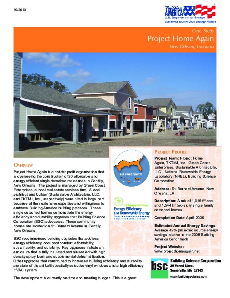

Project Home Again is a not-for-profit organization that is overseeing the construction of 20 affordable and energy efficient single detached residences in Gentilly, New Orleans. The project is managed by Green Coast Enterprises, a local real estate services firm. A local architect and builder (Sustainable Architecture, LLC. and TKTMJ, Inc., respectively) were hired in large part because of their extensive expertise and willingness to embrace Building America building practices. These single detached homes demonstrate the energy efficiency and durability upgrades that Building Science Corporation (BSC) advocates. These community homes are located on St. Bernard Avenue in Gentilly, New Orleans.
Project Team: Building Science Corporation, Project Home Again, TKTMJ, Inc., Greeen Coast Enterprises, Sustainable Architecture, LLC., National Renewable Energy Laboratory (NREL)
Address: St. Bernard Avenue, New Orleans, LA
Description: A mix of 1,016 ft2 one- and 1,544 ft2 two-story single family detached homes
Completion Date: April, 2009
Estimated Annual Energy Savings: Average 42% projected source energy savings relative to the 2008 Building America benchmark
Project Website: www.projecthomeagain.net
BSC recommended building upgrades that address energy efficiency, occupant comfort, affordability, sustainability, and durability. Key upgrades include an enclosure that is fully insulated and air-sealed with high density spray foam and supplemental dehumidification. Other upgrades that contributed to increased building efficiency and durability are state of the art LoE spectrally selective vinyl windows and a high efficiency HVAC system.
The development is currently on-time and meeting budget. This is a great achievement given that the team is integrating Building America upgrades in a production environment for the first time. The Riggio Foundation will possibly consider another Building America development based on the success and occupant feedback from this endeavor.
