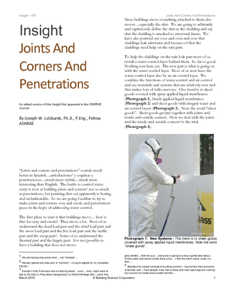

To help the claddings on the rain leak part most of us install a water control layer behind them.  So far so good.  Nothing new here yet.  The new part is what is going on with the water control layer.  Most of us now have the water control layer also be an air control layer.  We combine the functions of water control and air control and use materials and systems that are relatively new and that makes lots of folks nervous.  One trend is to sheet goods covered with spray applied liquid membranes (Photograph 1), brush applied liquid membranes (Photograph 2) and sheet goods with integral water and air control layers (Photograph 3).  Note the word “sheet goods”.  Sheet goods get put together with joints and inside and outside corners.  How we deal with the joints and the inside and outside corners[3] is the trick (Photograph 4).
Photograph 1:  New Systems - The trend is to sheet goods covered with spray applied liquid membranes. Note the word “sheet goods”.
