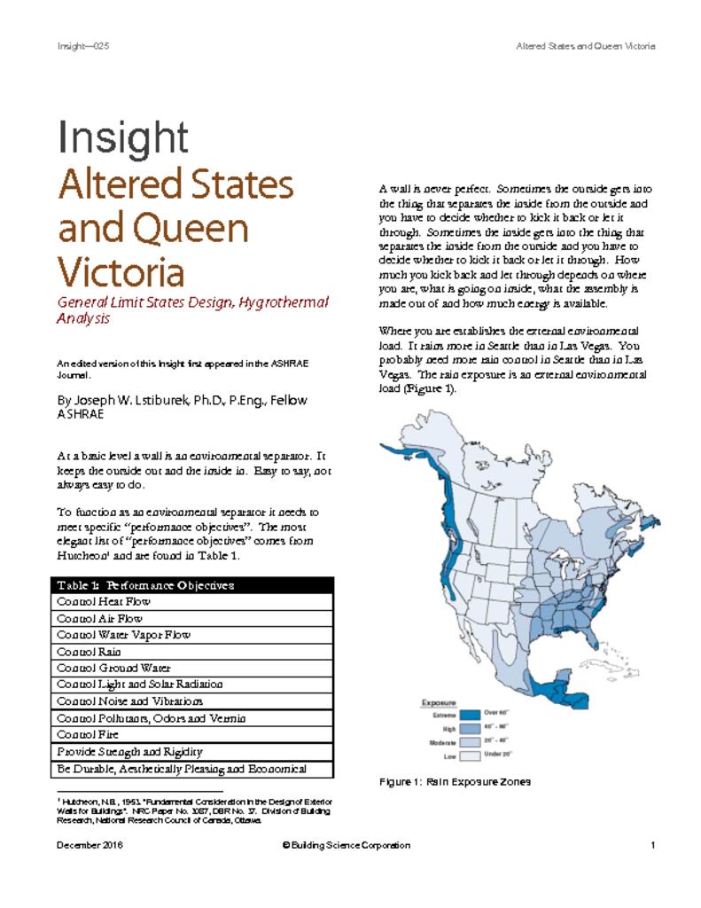

At a basic level a wall is an environmental separator. It keeps the outside out and the inside in. Easy to say, not always easy to do.
To function as an environmental separator it needs to meet specific “performance objectives”. The most elegant list of “performance objectives” comes from Hutcheon[1] and are found in Table 1.
A wall is never perfect. Sometimes the outside gets into the thing that separates the inside from the outside and you have to decide whether to kick it back or let it through. Sometimes the inside gets into the thing that separates the inside from the outside and you have to decide whether to kick it back or let it through. How much you kick back and let through depends on where you are, what is going on inside, what the assembly is made out of and how much energy is available.
Where you are establishes the external environmental load. It rains more in Seattle than in Las Vegas. You probably need more rain control in Seattle than in Las Vegas. The rain exposure is an external environmental load (Figure 1).
There is more. It is hot and humid in Miami. It is cold and dry in Edmonton. Walls in Miami look different than walls in Edmonton. The temperature and humidity outside is an external environmental load. They are referred to as “hygrothermal loads”. Figure 2 is a map of “hygrothermal regions”. If Figure 2 looks somewhat familiar, it should, it is based on the Koppen climate classification system (Figure 3). The model building codes “Climate Classes” are derived from Figure 2[2] (Figure 4).
