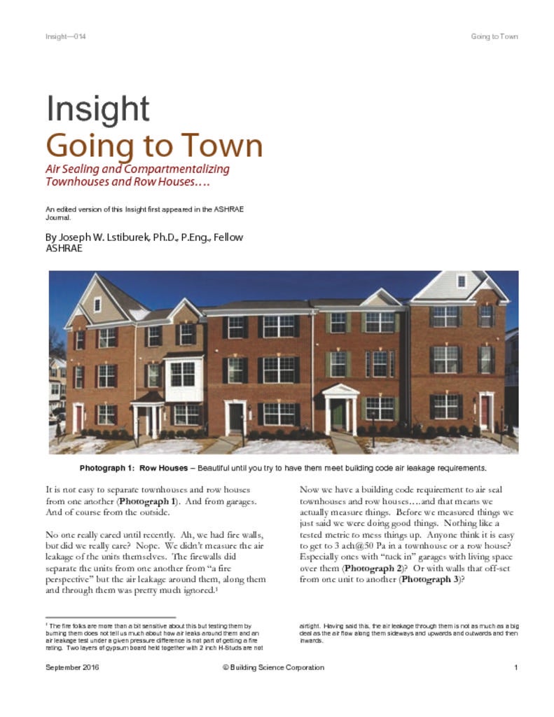

It is not easy to separate townhouses and row houses from one another (Photograph 1). And from garages. And of course from the outside.
Photograph 1: Row Houses – Beautiful until you try to have them meet building code air leakage requirements.
No one really cared until recently. Ah, we had fire walls, but did we really care? Nope. We didn’t measure the air leakage of the units themselves. The firewalls did separate the units from one another from “a fire perspective” but the air leakage around them, along them and through them was pretty much ignored.[1]
Now we have a building code requirement to air seal townhouses and row houses….and that means we actually measure things. Before we measured things we just said we were doing good things. Nothing like a tested metric to mess things up. Anyone think it is easy to get to 3 ach@50 Pa in a townhouse or a row house? Especially ones with “tuck in” garages with living space over them (Photograph 2)? Or with walls that off-set from one unit to another (Photograph 3)?
